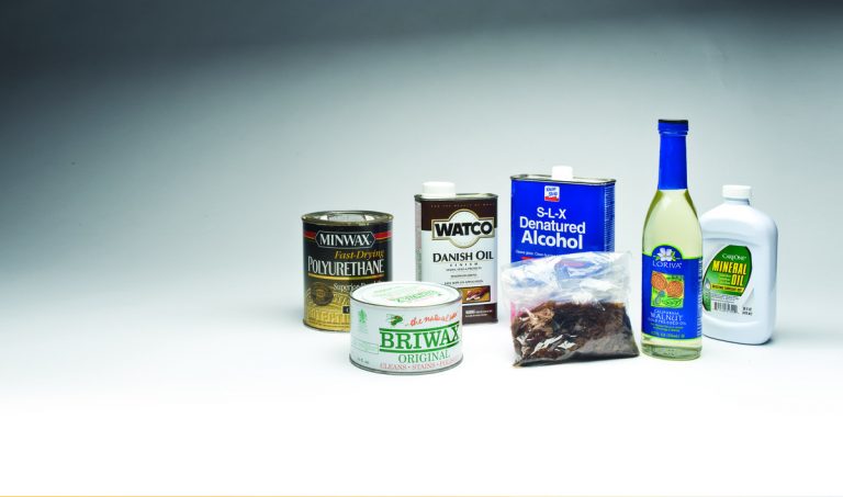

Finishing
Redheart sands well. Unlike some of the oilier tropical hardwoods, you don’t need to pretreat it before gluing or applying a finish. Unfortunately, as with purpleheart, the vivid color fades to a reddish-brown when exposed to sunlight; a finish with UV inhibitors, such as spar varnish, will slow—but not stop—this color change. I suggest keeping it away from strong light as much as possible.
